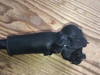

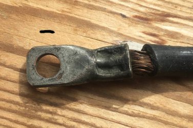

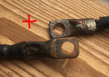

My OEM cables.
You can see from the first photograph how hot the cable got. The other two show the positive (+) and negative (-) ends of the cables. The difference is electrolysis, over the years.

Wow  :o!
Yeah, jeez, play fair  :-*.  Get the wire brush and a bit of lemon juice out, at least once every 10 years or so ...  8)
