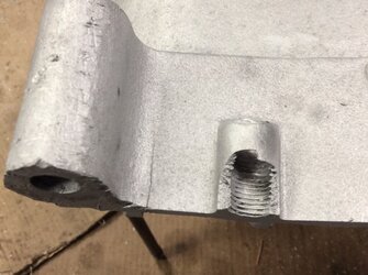

A 3C crack looks like this... never mind the thread damage! Before and after.
