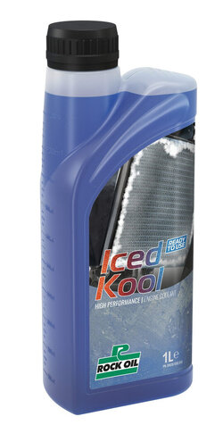

This. Buy it at the same time as your TRM - you do use TRM, I trust?
(And p.s.: it's main function is as a coolant).
"Iced Kool is a high-performance, ready-to-use engine coolant which helps engines run cooler in arduous racing conditions, protects multi-metal cooling systems and provides freeze protection down to -34°C. Iced Kool should only be used as a complete engine coolant, not further diluted. It is suitable for all engines, including those using Aluminium Alloy materials".
