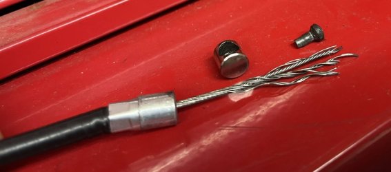

Sadly, after five years of testing Venhill clutch cables, including working with them in an attempt to redesign the cables so that they fit and function correctly, I am forced to accept that they are not fit for use on a bike that is ridden.
I had "standard" cables fail within four weeks. The "Heavy Duty" ones are completely unsuitable and prevent fine control of the clutch.
My most recent co-designed 'Mark 2b' sets failed at 7,461 and 4,880 miles respectively.
My next tests will be on Jean-louis' and Werner's cables, to see how they hold up.
I will report back when I have data to share.Clutch Cable Mark II Lever Headlamp.jpgClutch Cable Mark II Yoke Tank.jpgClutch Cable Mark II Carb Airbox.jpgClutch Cable Mark II Gearbox end.jpg

The problem arises because of the advances (?) in cables over the years, Piet.
The OEM cables had a a large crimped trumpet nipple inside the barrel nipple in the handlebar lever. The OEM cables announced that they required replacement by showing a a few separated strands.
OEM after 20,000+ miles
Modern cables are capable of carrying a greater load from a smaller size, much like modern chains, which should make for better feel and less friction. Unfortunately, Venhill can no longer source trumpets and barrels like the original, they use a much smaller trumpet, little bigger diameter than the inner cable itself. The problem is exacerbated by soldering, as opposed to crimping.
Venhill after 2,300 miles
Consequently, the stresses cause premature failure.
The cables are a service item and should be replaced before failure but, according to Venhill, service life should be at least 10,000 mls./16,000 kms.
To be fair, my living in London means my clutch almost certainly gets used a lot more than those living in more rural settings.
Having a cable fail in rush hour City traffic is also a great deal more hassle which motivates me more highly to find a reliable solution.
You pays your money,...
View attachment 93441View attachment 93442
View attachment 93443View attachment 93444
Lots going wrong with that cable, looks like the cable outer is too small causing it to rock and wear the aluminium feral.
My 750 has a heavy pull and I spent a long time routing adjusting and setting up to get it right. Friction ( caused by heavy action) can cause the barrel to stick in the lever ( sometimes a slight ticking can be felt) which in turn gives the cable a hard time just at the trumpet- add this to the fact the cable has been heated up at the same point and you’ve got a stress raiser. Worn clutch lever barrel bore can make the pull lopsided- causing more stress on the exact same point. Old levers,pattern cables , poor routing and of course total length can all add up to self destructing cables. I had mine made up by JJ cables and they are very good quality, no problems- had copies made from genuine ‘69 cables.
