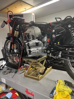

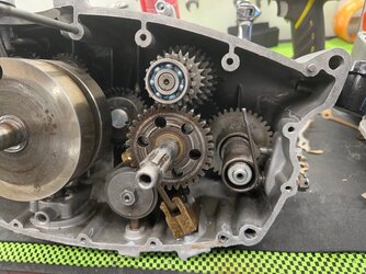

you called it...... roughly three hours tonight to engine out and cases split. Going to Keen Sert https://macrosfastening.com/keenserts/ all of the threaded holes in the split cases. Bearing pulled out of the case on the transmission shaft, going to pick up a new bearing "while I am at it", the kick start internal spring also broke which I will have to source.

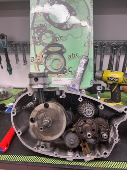

I bought the case sealer goop specific for split cases. I also got a new engine gasket set. The split case gasket is bloody thin paper. I am wondering whether it is even worth using together with the case sealer goop, or just skip the gasket altogether and just slather on the goop. Thoughts or opinions?

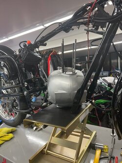

Also interesting, of the 4 engine mounting threaded rods, two of them had broken while I was test riding the bike, the nuts snapped right off threads and all. Going to pick up round stock and thread up four new engine mounting rods. While exhaust is off I am going to weld in an O2 bung so I can use my Innovate LM2 https://innovatemotorsports.com/products/lm2.php to finish jetting the new Mikuni VM 18 using real air/fuel ratio info when the engine goes back in.
I really really did not want to pull and split the engine, but it has to be fixed correctly. (y)I still can't ride due to back issues from the Kawasaki H2 SX SE pinning me to the ground in Nelson. BC, still going to physio, so I am using what should be riding time to fix stuff..... just did a ton of work on the 94 Harley Electra Glide Ultra Classic that I had been putting off for about two years;)

Being dead correct, you should do a trial assembly without the gasket - dry - and check the gearbox functions correctly. Losing only a small amount of endfloat can sometimes bind the lot up. If it's looking good, just the sealant, no gasket.
