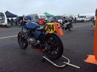

I took the SF750 and my CB900F to the track day on the Friday to set up the Honda for the race weekend and to run round on the Laverda. The SF went really well and apart from a few gear change issues we had a great time. I hired an instructor to give me some guidance and he confirmed the Honda was touching down on most of the right handers and that I needed to hang off more if I wanted more corner speed. The rebound damping was all off but by the end of the weekend I'd got the Honda running beautifully, although not very fast as it won't breach 100mph along the straights. Still, it'll do sub 2 minute laps and I ended up 2nd in the Japanese air cooled pre-1982 unlimited class.
The Laverda didn't like the weekend. I'd fitted a brand new Sachse ignition system, coils, leads plugs etc and made sure the sparks were big and clean and she ran fine on the Friday. Come Saturday the gear change issues became a bigger problem and she started to splutter on the two big right hand sections (Coppice/Charlies, then Park/Chris). Both of these were after the long straights. Phil Todd came along and gave me some excellent suggestions which we put into place for the Sunday. The main one was to resolve my gear change problem - it would go 2, 3, neutral then 5th gear. Saturday afternoon I knew that to go up a gear from third I needed to move the lever up, clutch out (false neutral), no revs, up again, clutch out (into 5th) then down into 4th. I was getting the hang of this but it did slow one down on the straights. Phil showed me how to loosen the mesh between the selector rod and the gear change drum and when I did that, it worked a treat. The only lingering issue was the length of the gear change arm which was too short to get my boot under - so when going up the gears I had to take my foot off the peg to allow my toe to fit under the lever. As it is a fixed lever arrangement (beautifully made I'll add), there was no adjustment so it'll have to be replaced over winter.
Then there were the fuel issues. A thorough analysis of the problem and where it occurred led us to believe the carbs were being starved of fuel because after a long run at full throttle down the straights, in the next section the bike would splutter giving me no confidence when "smoothly" rolling on the throttle. Fortunately the Contis stuck like glue as the bike rocked back and forward. We messed about with fuel taps, hoses and new fuel but in both races I couldn't complete the formation lap properly and returned to the pits.
Given the fuel crisis, I decided to drain the tank so I had a Jerry can of petrol for the wife's car and it was then I noticed the problem. When I opened the fuel taps, there was full free flow for a few seconds and then it weakened to a dribble. Close the taps, wait a few minutes and try again and it did exactly the same ! All our static tests (does it get good fuel flow?) showed it was fine but as soon as you left it for a few minutes, the fuel flow almost stopped. Turns out the rubber seal in both taps had swollen. The process of closing the tap squeezed the rubber into the right shape, so when it was opened the hole was full size. After a while the rubber swelled up again and blocked off the hole. Close the tap and that action squeezed the rubber back into shape.
A blast down the A513 this week and the bike spluttered like a bugger after a few miles, but if you opened and closed the taps a couple of times the problem disappeared.
As I said to Phil, it's good to find the problem and it's great when it's easy to fix !
