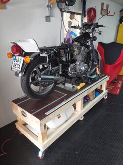

Built my own with detachable thunderbird ramp 😁, space for storage underneath & pull out for front or rear wheel removal. Only downside of course is that the height is non-adjustable.
