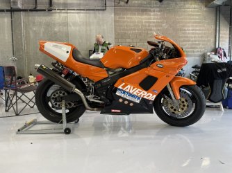

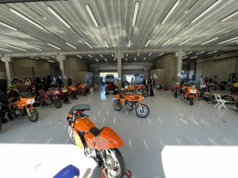

Last weekend we had a great weekend at Spa Francorchamps with the Laverda’s.
Great wether. In the box were 10 orange bikes and at the paddock same number I guess.
The Zane 650 was fantastic.

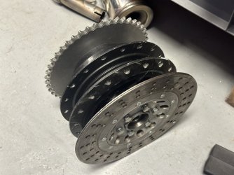

Did Larry's bike come complete, Marnix? I bought his SFC rear hub, disc, sprockets. He'd converted to Suzuki cast wheels. Or did he have another SFC? I thought Wolfgang had Larry's old SFC.
Yes it did come complete in urgent need of a complete overhaul. When Larry Strung raced the SFC in the 80ies he didn’t trust the magnesium hub and fitted a Suzuki GS750 rear hub. Tim Parker did same with his Elettronica SFC at the time. I removed the hub and fitted an original magnesium hub and disc. Never had issues with them. Still have the Suzuki hub (photo).
Wolfgang did buy the SFC off Larry, yes. Then it went to Germany, then Scotland and finally Holland.
