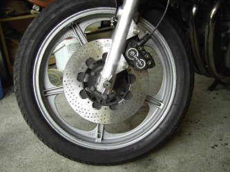

Here's my effort, correctly fitted to a '76 3CL.
