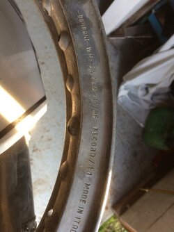

I am getting round this now, but have a Motor morini rim that is stamped as Record, my wheel builder has told me I need to make sure the drilled angle is correct, as your info has said I think I need to stick to 4445 and 4446 as they are mentioned with the Gremica hubs, although I thought the Motor Morini hub was Grimeca. nothing seems ever straight forward lol. any input welcome. what price should I expect to pay for a good rim, and do second hand polish up OK. picture attached of the Motor Morini rim I have.
What imports is not the make of the drum, but it's diameter and diameter of the rim. That, will determine spoke angle I should think.
Borranis polish up very well. You can polish out scratches within reason.
