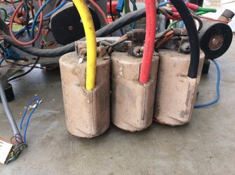

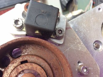

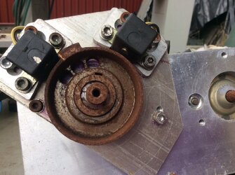

As may be of worth to the few, repalcement VR pickup from TEC and adapter plate to replace the OEM bosch pickup. Flat adapter plate not hard to fabricate, the pole face to impulse cam distance is set by the correct dimensions for the adapter plate, pictures tell more. Retained TEC VR pickups for some Ducati's i did with iis system, was popular with some owners, not all Ducati mob however.... Piccy of ND coils and 7m/m HT leads, just a guide as was my iis test jigs use. Yes rain got into the workshop many years ago.HTH. j
