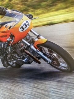

The former owner is well known and maybe he will post a comment or a video?
Oh, sorry I cut his head😬
in order to reduce chassis flex it is important to have a solid headstock and swingarm pivot contruction
You may ask yourself if this is the case with large tube frame types such as, Brühl, Egli, Martin, Rau, etc
That said, they are aesthetically very pleasing

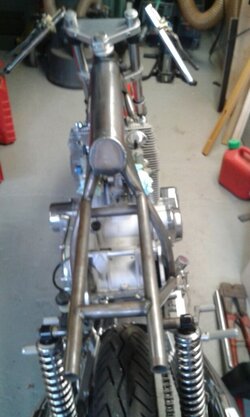

Just a few more.
btw. this project is for sale, too.
Situated in North Germany (Hamburg).
But won't sell it here before Volki sold his bike.
As I would have hijacked his thread otherwise.

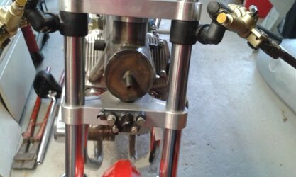

My apologies too for taking the discussion off course, no offense if a moderator wants to take this into a separate "alternate frames" or similar topic.
Good photos thank you.
Substantial plates to carry the swing arm pivot loads to the engine cases. That's what I'd had in mind to add outside the frame to supplement the thin swing arm supports on the Trackmaster but only got as far as cardboard prototypes. I'd been looking at how the '74 SFC frame is much more heavily built in that area than the other models' frames. Are the alloy plates part of the Bruehl kit, how thick are the plates?
