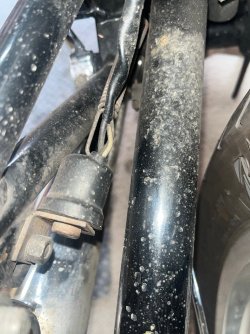

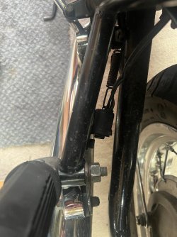

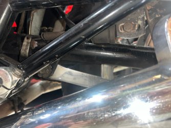

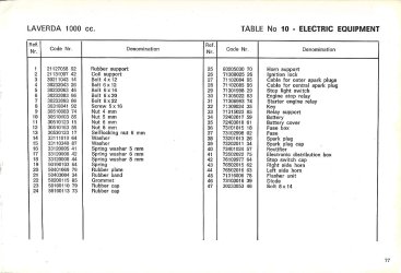

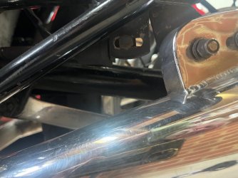

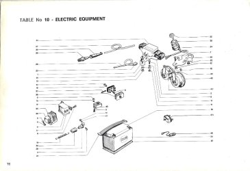

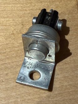

Can someone send photos of a break light switch, showing what it looks like and where it is supposed to be located, on a 1973 Laverda 1000, not everything is still present in my restoration project. thank you in advance.
This is what it looks like. Comes from 1950s Mercedes 300S and 1.2l Beetles. If you search for the parts number they do turn up occasionally. Some years ago Bosch made a big deal of their new Classic divison and their devotion to their heritage. Then they discontinued most of their Classic parts in 22....
