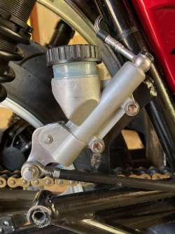

My rear master is occasionally seizing (or not returning properly) ... so replace or service - but what is it?
Only markings are 3J9. On a 1200 Jota America with standard calipers.

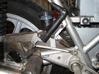

The master cylinder is standard Brembo fitment. I could tell you the additional return spring is a Brembo option, but I'd be lying.
I changed the lever ratios on my system and the M/C internal return spring wasn't quite up to the job of returning the pedal to the rest position, so I gave it a bit of help by adding the external spring.
Standard Brembo PS15 rear.  Uses the same seal kit as the front M/C.

PS15 it is! Thanks ... I'll hunt down a kit.
The pedal is returning fine (original spring to the brake lever - with no resets) but the gallery in the MC may be contaminated and not getting a fresh touch of fluid, so time to pull it down.
