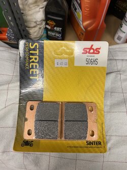

When I changed to stainless discs last year prior to the Pyrenees trip OCT recommended those to me:
This combo improved break performance vs the previous mounted cast/brembos - just work a treat!

I use those from OCT and so far they worked well 😊
