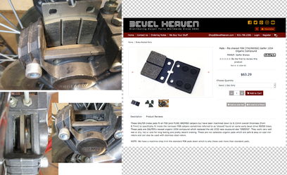

The front brake pads are "Sureflex" which I've never heard of. They appear to be new, but are an extremely tight fit against the rotors even w/ the caliper pucks fully retracted, which I've never seen on my other Brembos. The thickness of the pads and backing plate is @ 9mm- are there Brembo pads 7 mm thick to give more free play to eliminate brake drag and the part number? Thanks again!

OK, after some research I discovered that my Brembos are the narrower versions found on earlier Ducs, and that Bevel Heaven offers "shaved" pads. I also learned that organic pads should be used w/ cast iron rotors, as opposed to sintered that will chew up cast iron. The attached pics show how 9mm pads fit too tightly, even w/ the pucks fully retracted. I have no idea if these Sureflex are sintered or organic, so I'm ordering the ones from Bevel Heaven

OE Brembo pads for P08 calipers are 9mm thick. So begs the question - how thick are your rotors? Would help to post a photo of your fully retracted caliper pistons, and measure the caliper body gap where disc and pads sit.
Steve's (Schurminater's) photo shows the gap between new brake pads (with I guess part worn discs) and caliper body on his bike (albeit the latter maybe slightly off centre! :unsure:).
In a post by Ducati Paddy, he provided some measurements whilst answering a different question - see https://laverdaforum.com/threads/brembo-goldline-differences.93564/post-334417 However, I reckon OE Brembo CI discs on Laverda were 6.5mm. If correct, and assuming 26.4 is correct for the caliper body width between pads and disc, that would leave 26.4 - (2x9) - 6.5 = 1.9mm. I guesstimate that ties in with the gap in Steve's photo.

I miced the caliper body gap and thickness of the rotors- the caliper body gap is 25-26mm and the rotor is @ 7mm thick. 7mm plus 18mm for the 2 pads leaves only 1mm for free play. Or is 1mm free play acceptable- I think it would drag too much and over heat and warp the rotor. The pads are a very tight fit. The cast iron rotors have no stamping so I don't know if they're from Malcolm Cox (its got a Malcolm Cox exhaust) or Brembos.
Just noticed on Paddy's site, he stocks NEW EBC organic pads for Shaved Calipers and cast iron discs. 7.5mm thick especially for P08 shaved SS calipers.

1mm would be fine, but the calipers must be perfectly centred. Have you centred everything on the axle by bouncing it hard against the brakes before final tightening of pinch bolts etc.
