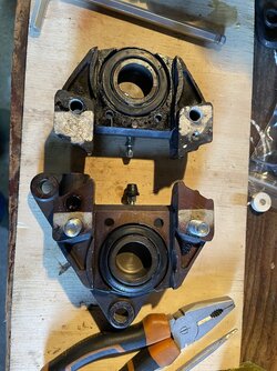

Having just had both my PS15 calliper’s refurbished (great job by Powehouse) and recharging the system, I have correctly bled the outside pistons. However I can’t seem to bleed the inner pistons, is there a technique I’m missing as it almost seems like there’s no flow of brake fluid into these?

They have two nipples on each calliper. I believe they are PS15s.
I’ve tried tipping them every which way but loose.

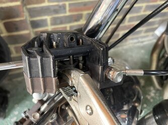

I have attached a clear drain tube to each nipple in turn and unscrewed the nipple whilst pumping the brake lever, each of the outer piston chambers fill the tube but using the same process nothing comes out of the inner piston nipples. I’m doing this one at a time with the calliper in place so the method is the same.
I think I might try compressing and clamping the working piston In with the calliper off the disc to see if I can “free” the inner piston by pumping the lever.

When I rework/overhaul calipers, I put the pistons in just so they do not fall out, fill the caliper with brake fluid, connect them to the system, fill the system (but the reservoir just 2 mm high to avoid overflows with the following step) and slowly press the pistons in while making sure, the brake line connecting point is the highest point of the caliper. That normally pumps the air out 99,9%. The rest is a question of slowly pumping the brake master at the point where the bubbles come up. If you have a resistance point where you can build up pressure, mount the calipers properly, pump the master and tie it down with some straps/rubber straps etc. so it holds the pressure. Air will come up in the lines over night...

I think i might know what going on here.
they have assembled these back to front. The rear of each caliper is handed and must match up with its original front.
If you want to send them to me i will check them over FOC and sort them out.
