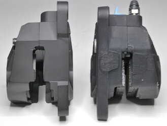

As it happens i am spending Xmas ever just refurbishing a set for a customer so here is one in fresh Cerakote.

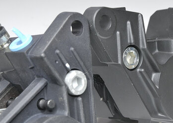

The calipers were shaved on the outside faces front and back removing the logo, putting a flat on the nipple casting
The side faces were also shaved seen here alongside a new P08 single nipple
The inside faces were shaved 1mm each so the gap for the disc and pads was only reduced by 2 mm overall
Also note the lip that would have held the pad cover is removed and the countersink for the cap heads was deeper so although there are only 2mm narrower they use a 45mm bolt instead of the std 50mm bolt
These early black calipers were also fitted with Teflon coated alloy pistons while contemporise at the time still had chromed steel pistons
