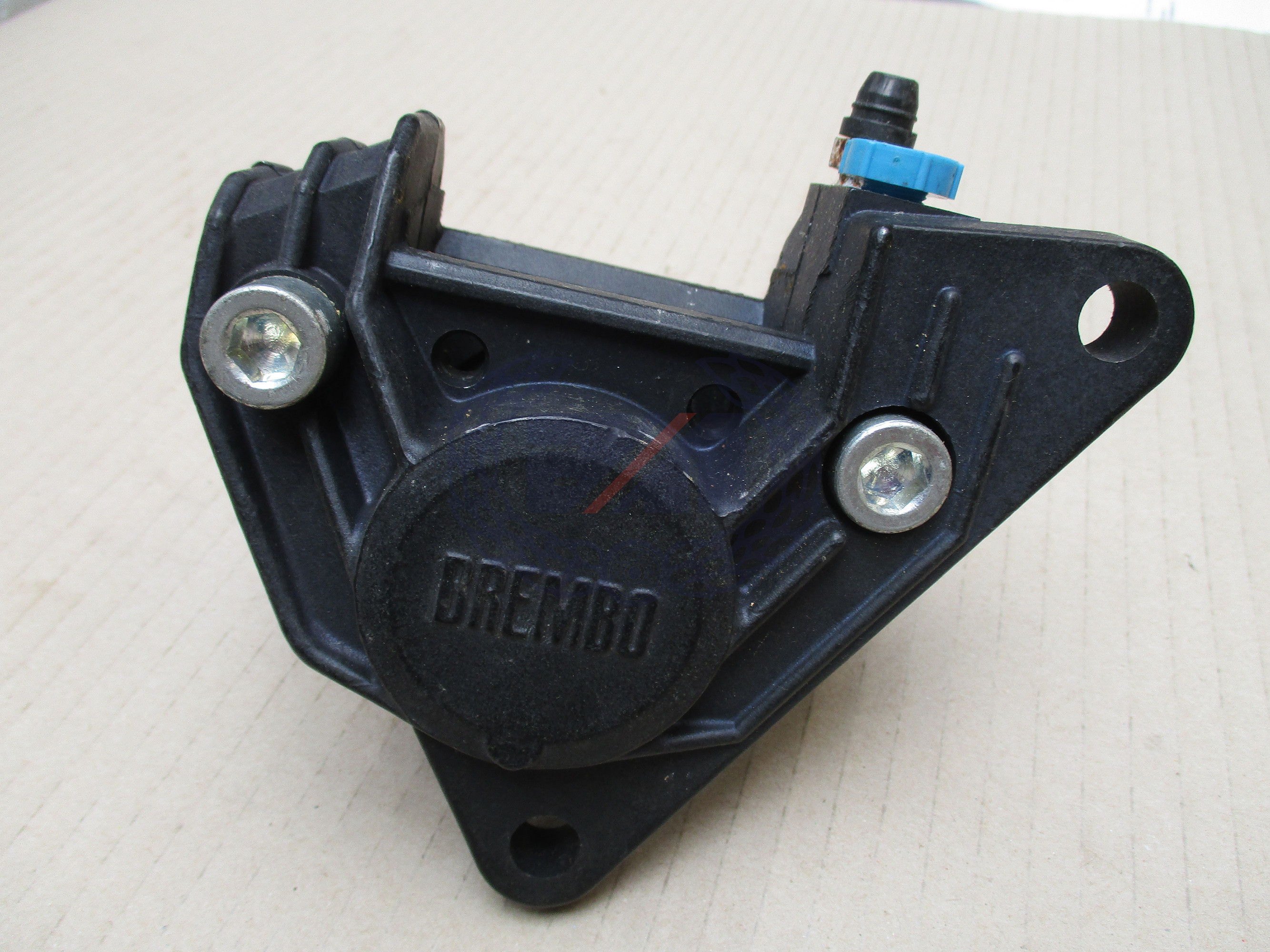

My poor twin bleeds are quite leaky from the bleed nipples, the threads are quite loose and can't find anyone near me (Cornwall) brave enough to time sert them (assuming the seat is OK)
Do the single bleeds from Andover Norton fit without fettling (I know they may need threading)?

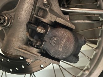

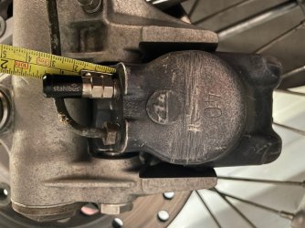

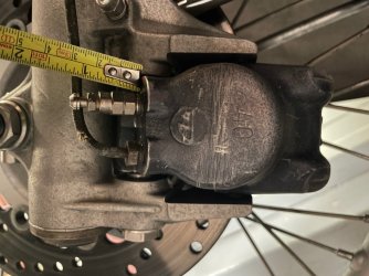

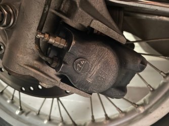

Ha! One hundred and one photos of my bike but none close up of the calipers with these nipples.
What I can tell you is that they stand taller than the originals so aesthetically they may not suit your taste.
I was unsure, but after at least six years and no issues and annual fluid changes, I'v had no issues.
I have now been able to source two NOS calipers and will in the near future swap out the old calipers as the piston support is worn
and will continue to use these Stahlbus nipples in the new calipers as they make bleeding easier.
If I can remember, I'll have a look tomorrow and take close up photos when back at the shipyard where I keep my bikes.
Old BMW ATE calipers fitted with Stahlbus bleed nipples.

I think fluid would still be able to escape through the central hole IF it is indeed the tapered seal that is allowing fluid to pass.
That's a good point. I think the slight weep isn't enough to make it through the central bleed hole (forgive the technical jargon...) and have assumed, possibly stupidly, that the fluid is drawing up through the thread by capillary attraction.
