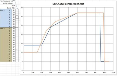

Just a reminder we're talking DMC1 here, not 2. Attached image shows that the usual curve 10 on a DMC2 (which a lot of us use to good effect on the 120 engine) almost matches curve 1 on DMC1. Curve 2 only gives 26 degrees max advance, assuming the base setting is correct. The only difference is that DMC1 drops full advance at 8500 rather than 9k. You can play yourself with the spreadsheet that Cam created - it's in the library.

Thanks ksoholm. I'm learning from above reply's that curve 10 on a Gen2 corresponds closely to curve 2 on the Gen1 unit, which I have. As soon as I get a delivery of parts from Wolfgang, I'm going to start tuning from ground zero: valve check/adjust, carb sync., check timing etc. Hopefully that will result in better manners.
That's because you guy's have the second generation which has many more curve options, about 15 or so. I have the first generation which "only" has 8 curves to choose from.
and the published curves are not what is incorporated inside the DMC's.... mapped a cross section of the curves many years ago.... more the matter of how it feels for your country and riding style, at days end, let alone state of engine tune....j.
