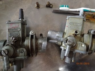

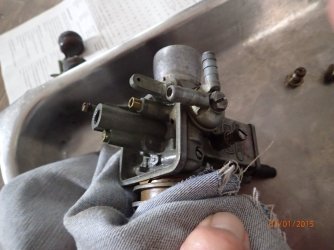

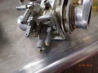

It is plain to see these needle seats do not have a hex fitting for removal. I have 4 30A VHBs. All have the same brass seat w/out a hex fitting. So a stud wrench to remove? & then it was 4 yrs ago that I had the tank redone & they used the Redcoat on the inside. Old 15538 ran beautifully up to a yr ago when one carb started to leak! So I replaced the leaking one & then the other side leaked. Then I get too busy in the summer to do anything.

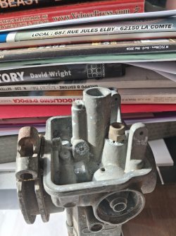

Well, at least the VHBs as used by Laverda have cast-in/pressed-in float valve seats. I'm guessing the pic that Paul has posted is of a Guzzi version as there is no thread visible where the main jet holder would go in. The Guzzi types have a completely different main jet and atomiser set-up which also houses the accelerator pump.
Mea culpa.
I've looked at other VHBs and the seat is a press fit.
