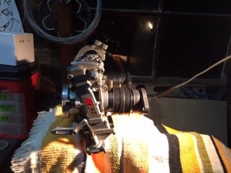

My two are linked by tubes across the float bowls. The one Lee swapped for my plain one was so I can have a pump for each pair (mine came off a four cyl so only one pump for the bank of four). I had to drill and fit a brass tube from the blank float bowl ... tricky job, lining up with the internal cavity.
You can see the lever on the carb in the pic - I've since moved the pivot point and plunger pin point altered the pull ratio to give more swing at the thumb lever (and clear the intake tubes that weren't fitted when i made the bloody thing!!).
The thumb lever started as a SRAM bicycle shift lever (broken mechanism). Insanely highly engineered thing with the lever running on two miniature roller bearings!! Was tricky making the housing for the cable fitment and getting it to sit neatly under the LH switch block. Worked out well in the end. Another eg of the ludicrous amount if time I'm spending on this bloody SFQ!!

Cos I bought them for their super accurate carburation, nothing else. As the Tipmeister says it only takes a squirt in all weathers to fire the bike up - and that's with only one carb/cylinder. I have been offered bodies from the 'road' version, with choke galleries all open and a proper choke system, but at this stage I don't think I need to do all that faffing around. Obviously Suzuki didn't want to sell a bike where you basically relied on squirting the throttle to start it. No 'pull choke' to be seen on my FCRs.
If the choke button was easily accessible. Mine were bought new and fitted to an SF. The expert setting them up told the owner that they couldn't work properly as the 39mm was too big and impossible to tune to an SF, so he sold them to me and bought smaller ones. I set them up as good as I could ever want a carb to be, I don't know what the problem was. We are way off discussing pumps on Dells though.

Basically, I've never really been able to afford FCRs. But about 25 years ago a bank of four horizontals (as against the Yamaha downdraught type) came up for sale for about $800 or $900 in the good ol Trading Post. From a Suzuki GSX-R1100 IIRC. The guy posted them down from Sydney in an Oz Post box that reeked of petrol fumes!! No way today, Jose!
Anyways, turning 1x4 into 2x2 was no easy feat, cos the four only had one cable mechanism, one spring, one long hard-chromed throttle shaft, one pumper and one idle speed stop screw ... oh, and no choke!  :D Plus a load of other things like fuel pipes, breather tubes and T-joints or L-joints that didn't suit the SF cylinder spacing. Came together after much thought and playing on the lathe and ... I found that Wemoto in Japan can source virtually every part on them, and their prices are probably half those of the rest of the world. FCR stuff is hellishly expensive (for a mere peasant like me anyway). Four new needles, various assorted jets, o-ring sets, springs and the like were shipped to me a few years back, so hopefully I have everything I need.
Two pairs of twin FCRs new would set me back a shaez load more than I've spent. I'd love to be independently wealthy but I'm an old Laverda punk who got their bike back in the 70s when a young Laverda punk could own and maintain them on a pauper's wage. These days the dough mostly goes to running the family of four.
