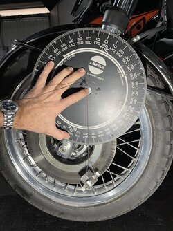

Anyway, here a low motion video of the contact and the degree meassurement of the fork:

Taking the angle with a plumb does not conform with the specification unless the line through the rear lower engine mounting are horizontal, as per the diagram.Miguel's.jpegLaverda Triple 180 Frame Measurements.jpg

Oh true, you are damn right!😑
But ok, this doesn’t change the issue that the main tube has an slight bend when putting on it a straight bar… so i need to increase that clearance with the front bracket. Other Laverda owner did it with those shose shorter pipes… i don’t see anything else apart of building it apart completely and making it straight with chains and lot of power😮‍💨
I was thinking that yokes cannot be bended as I would have had issues installing the fork stanchions

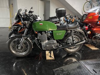

I bought the correct downpipes from Wolfgang for my 3C with no issues, ,more curved than a certain supplier of Jota pipes I believe. Centre bike in photo..That or tougher fork springs ;)
I am using original downpipes rechromed, so the curving is probably not the issue, tougher forks would help as well for sure... feelingwise they are too soft... but they have correct run. I measured around 100/110 when balancing the bike with my weight holding the front brakes.
I would go with firmer springs for sure though.Also check the length of your springs,my drummers Ceriani ones are longer than 750 ones I got from Keith, ,I"ve seen mods and also suggested by Wolfgang to add solid top spacers like round polyurethene .
