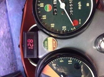

Shendengen 530 from the wreckers is pretty reliable. 3c is charging at 14.7 v, tried 3 different refs, all the same. Parker?s on gives 14 v. I have a $15 eBay special LED volt meter double sided taped to the top of the instruments, just to keep an eye on it. I ordered another for the 750. Will mount it up tonight. Might invest in a couple more, batteries exploding between your legs is not a good thing.

Great minds think alike Marty. I've had a voltmeter on my Jota for a couple of years now, after it failed to charge on a ride and the battery went flat (no GEN light  ::)).

I have been meaning to get a couple of those gauges for my bikes, how hard is the wiring to do and whats the preferred colour, be good if it's seeable but doesn't constantly catch my eye.
Easy to install.  Red is ok but you cant see it in the direct sunlight very easily.  The new one for the 750 is green.  $15 free delivery, i chose an australian supplier, to keep tc happy, but there are cheaper ones.
These are very useful as a monitor and not expensive.
They can save you from regulator runaways and from stuck on starter relay problems.
Could even be fitted in the clock faces, using one of the unused jewels, if you don't want to ruin the original look.
http://sparkbright.co.uk/sparkright-eclipse-battery-voltage-monitor.php
Both the blue and green voltmeter displays are readable in direct sunlight. Haven't tried a red one. The green on my Benelli looks very bright in the picture, but that's because the photo was taken in the evening gloom inside my garage. It's not too bright when riding around during the day. I haven't ridden the bike at night since I installed the meter, so can't comment on its brightness in the dark.
I think the first one (blue display) I bought a couple of years ago for the Jota came from China for only a couple of bucks. I actually bought several of them, including a couple that plug into the cigarette lighter on a car dash.
I bought my last one with the green display a couple of weeks ago from an Australian Supplier for similar reasons to those expressed by Marty and TC. I think I paid $15 too. However, the Aussie supplier probably sources his stock from China so I suspect my "buy local" protest hasn't achieved anything.
I tried one of those Sparkright battery monitor lamps several years ago and was unimpressed. It doesn't tell you the system voltage. It goes through various colour changes and flash sequences to signal different charging system status events. You have to remember what the signals mean, which can be an issue if you only ride the bike occasionally. I also found the colour changes and flashing antics a bit of a distraction. But at least it didn't distract for long. The thing stopped working altogether after a only couple of months.
Installation is dead easy, as Marty says. The display itself is attached with double-sided tape and there's only 2 wires to connect - a 12V feed that switches on with the ignition, and an earth.
