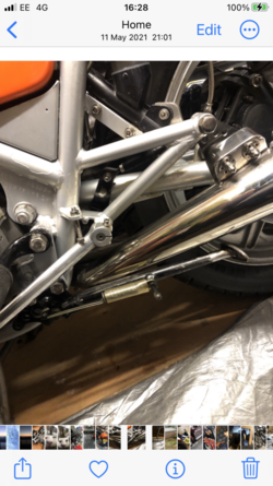

Here is mine - no rear sets
Thanks,
Julian

Thanks Paul.
Looks like there’s fair spacing out of it too. I’d imagine the dimensions need to be quite carefully worked out to provide clearance of the exhausts without having it hanging out to the side too much.
Thanks,
Julian
I had no problem whatsoever with the exhaust. I should think that pushing the stand back moves it away from the silencers.
It does however require a shorter stand to avoid the bike being too upright, ZZR100 instead of 600, or vice versa. :)
Great, thanks Paul. I’ll look into it. 👍
