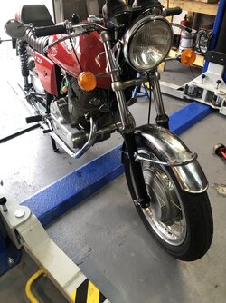

Just to finish this off - I used 170ml of 30wt in each first and gave it a run, and it felt a bit solid, so drained it out (got 150ish ml out). Replaced with the 20wt and that seems fine, I only bought it earlier this year and is my first Laverda so no expert, but whatever was in there was a sludgy brown mess, and it all feels so much better, - once i'm used to it ill have a look at the springs I went with 10mm of spacers for now.
It's feeling like a different bike to when I bought it, to be fair I wanted a Laverda and it looked alright not enough science there, so ended up with lots of bodges by someone who clearly was partially restoring classic ornaments, and didn't care too much about safety or reliability...but with the help of many on the forum I've undone the bodges and fixed the major issues.

I usually find it better to start with light oil, and go heavier, up to the point where fork control becomes acceptable. Ensuring maximum compliance, whilst having damping control. Quite difficult with the 35mm Ceris though as, in my opinion, the balance between compression and rebound damping is not great in stock form.
Good work sorting the beast, Franc. Sounds like you had your priorities right. I thought 30wt sounded a bit on the hypoid gear oil spectrum!
I did some major engine work on an SF1 and was then asked to fit it to the frame and get it registered. First ride the front end felt like it was rigid - pulled off a fork cap and found oil to the top - there were many many more 'issues' uncovered in the time I worked it into rideable shape - DPOs are capable of absolutely anything!
Dare I ask what to do about the Koni rear shocks - do the originals ever come up for sale, the Konis are really solid!
They shouldn't be, if correctly sprung for your bike. Genuine Konis could be rebuilt back in the day, and Ikon are very similar so service parts / alternative springs may be available.
The Koni shocks are Koni not ikon when I bounce on the bike (I’m 112kg ) I get max 5mm drop with the spring preload at lowest setting, they are in immaculate condition and are the correct one As stated at the time for an SF. They are just way too hard maybe faulty..?
Take one shock off at a time and try your bounce test again. Maybe one is faulty or bent?
If they both are the same then somebody previous has thought harder springs meant better suspension.
Actually, before you do that… is your chain too tight?
I’ll try that maybe one is faulty have never taken them off or experimented individually I’ve got 30mm of play in the chain and I checked the swing arm was free this morning I thought that could be the issue.

I've ridden on Konis and they are pliant and work well. I fitted them to that SF1 I mentioned above (that had the forks filled to the brim with oil) so I could get it registered - the Marzocchi Stradas that were on it were seeping but were like riding on solid steel rods by comparison with the Konis.
Don't mix up ride height adjustment with spring rate either - the adjusters will lift the bike but have zero effect on spring compression rate. If the dampers are functioning OK you need softer springs.
Do your Konis have the 4-way damping adjusters below the rubber cover at the top of each shock. Check to see what number they are set too. Icon has available 2 springs std and heavy-duty for shocks they supply. Identifying your springs from those two, or even if you have something really odd takes some trouble, I have had springs identified at spring makers where they have gadgets that compress and log the load that takes but finding someone to do that isn't easy. BTW Icon in OZ are exact Koni replicas, they bought the Koni Manufacturing gear when Koni stopped building bike shocks so all pats are available from them. I don't like the multi-rate springs Koni and Icon use, I don't pillion so I had Icon make straight rate springs to suit my weight, that worked out well. BTW that one shock test is a great idea, and will as you say check for a load of issues.
Please note that the drum brake 35mm forks and the 38mm disc brake ones have nothing in common construction wise, other than that they were made by Ceriani. The 35 needs a much thicker oil to work well (in 20-30W range approximately ) than the 38 forks (in 5 to 15W range approximately).
