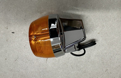

Those CEV indicators tend to fail in the threaded holes that the lens fixing screws go into. It's a crappy design because there's not much plastic around those holes and they're self-tapping screws that put outward pressure against the hole bores. It's almost like they deliberately designed it to bust the sides of the holes out. Easy enough to repair by building up with epoxy and re-drilling the screw holes. The repair usually ends up stronger than the original, so I consider it an upgrade. It isn't visible when the lens is in place. I've lost count of the CEV indicators I've epoxied up over the years.
