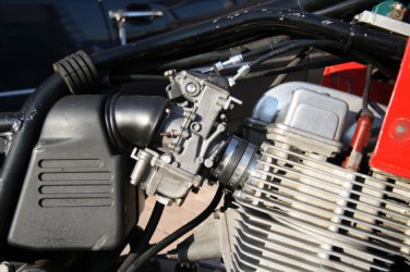

Can someone post a pic of Miks close up on a RGA as I havn t seen them on one please.

Hi Geoff,
Well I would say any carb from an oil cooled GSXR or early Hinkley Triumph is definately side draught.  I would consider the FCR's on Lothars bike to also be side draught.  The term is related to the orientation of the airflow, so to be "downdraught" in my book, the carb port has to be 45deg or greater from horizontal.  Carbs I would consider downdraught - early Yam FZR, Hon VFR, etc.  FCR's have a float bowl adapter for applications at greater than xx degrees.
Any carb mounted to a Laverda would by definition be sidedraught, the cylinder is at 15deg and the inlet port a further 12deg - 27 from horizontal.
It's nothing much more than a marketing term anyhow, air is air and it will go where the low pressure is, the main "thing" with the term downdraught is it usually might inply a straighter port to the inlet valve, something that is totally impossible with a stock Laverda triple head due to the inlet bucket bore being completely and utterly in the way.

Hi Steve,
the Keihins are only available (to my knowledge) as Horizontal (float-bowl is almost straight under the carb) and Downdraft (float-bowl is angled at roughly 45?)
The Horizontal are recommended from 0? - 35?, the Downdraft from 28? - 90? (!!), but with some degree tolerance. So - officially, mine are Downdraft, though they are installed almost horizontal.

Hi,
Thank you for the good feedback.
I have looked at the downdraft carbs I have laying around, and I think they are from an early ZX7 - Keihin CVKs.  I can certainly see the difference now, and understand that the pictures are sidedraft.  Thanks.
I am still confused about the angles, and see mention of Red's angled inlets.  Are these to help miss the carb hitting the frame (on a 180' series-2?), as well as perhaps matching the carb bore?  I realise the different model carbs could have a different headroom requirement.
Thanks again for the help.
Geoff
