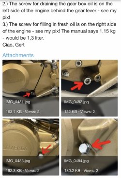

Do some research, first time I changed oil on my Bonnie, the Gearbox detent spring and plunger came out, I took the wrong bolt out.
Of course not Growler, look at the pictures, it has a big mother fucker red arrow between the frame and the case pointing at it. None of my vehicles have oil drain plugs that say what they are.
I don’t think I even read it, thought picture was filler and a sight glass
But then I was intrigued
The Japanese think of everything, I have flipped picture as bottom of sump but arrow to drain plug (but not a big RED one)

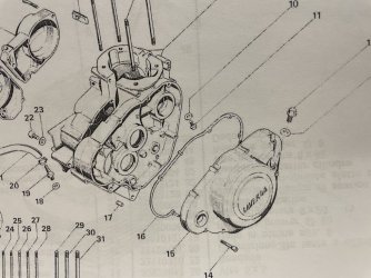

If cover will clear looks like this gasket can be changed or maybe you might need to remove engine bolts a swing/lift engine for clearance depends where leak is
