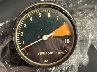

The clocks of the CB750 K1 did have the idiot lights, but they indeed had different ratios and.. they are harder to find than the Laverda ones.

You are right Marnix! I thought of the early K1 clocks, but haven't seen any for sale in the classifieds in ages.
IIRC the backs of the ND are different as well, and some have the trip reset knob on the side.
