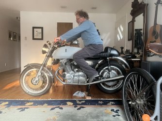

Wondering if anyone has feedback -negative or positive, feel free to pile it on- on my set up plans for bars and pegs. I've got Tarozzi rearsets paired with bars from Wolfgang that are a bit higher and more pulled back than the originals. On most bikes this would seem like a bad combo, but the Tarozzi's don't seem to be set extremely high or rearwards, and the SF frame is kind of long. Net result feels kind of like a dirt tracker (which does not seem that damn bad in my living room)...or am I missing something? Pic appended for reference.

& your riding position will change w/ boots and being pushed against the bum stop. Nice air conditioned workshop!
For long-distance comfort, I wanted lower foot pegs 30mm to open up my knee and hip bend angles than std rear sets give and 20mm higher bars to straighten my back. I am 5ft 11 although I appear to be shrinking. That's on a 3c. Fiddling with egos is fun and helps lots.
I’m 5’10” and the bars on my 750 could be moved closer in due to the tank and your arms appear a bit stretched in the pic. Possibly angle them in closer if it feels better. Is that a double pad brake caliper and what shocks are on it? Nice looking bike-
Handlebars are easy to change around, footpegs not so easy. I set my handlebars so that my hands fall naturally onto the grips. I doubt you will be riding with straight arms and high shoulders like in the picture. Those pegs are not very rear-set and look about right. It also depends on what type of riding you are into. Out for a blast through the favourite road of corners is very different to enjoying the countryside as for ergonomics setup. Also, before my recent Italy ride I swapped my alloy foot-pegs for steel ones that I could fit std Lav rubbers to, it helped heaps with the vibration of the SF and I didn't notice the 1cm height increase.
I wanted the ability to easily and quickly be able to adjust the footpeg height. It's doable on my setup but not an easy job. Low for comfort and high for ground clearance.
It's your joints, do what you like.
I'm putting marginally higher bars on my SF2 this winter. There's too much weight on my wrists.
You're going to have a sore bum after a few hours on that seat.

Thanks. Shocks are Ikon, and the calipers came off a BMW. Got the idea from another forum member. They have the same bolt pattern as the stockers. Need to swap the lower stanchions left to right and add a spacer. I also changed the master cylinder with one purchased from Michael at Vintage Brake. He is great to work with.

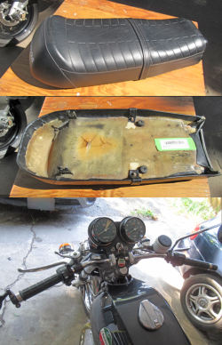

Not sure if the bars are standard or not, but I rotated them slightly towards me to shorten the stretch over the tank.
It came w/ a dual seat- the cover was $220 from Wolfgang, Auto Trim Specialists in Denver attached it to the base for $125
www.motorrad-technik.de charged 337,22 for the base- not a very good casting job as you can see
It also came w/ the solo seat that I find comfortable and I like the storage box but find it fugly- I like the solo seats w/ the upholstered hump better
