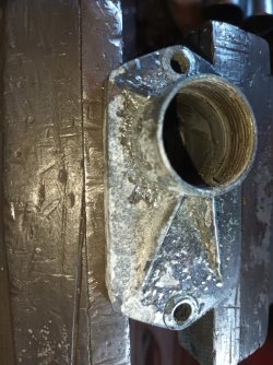

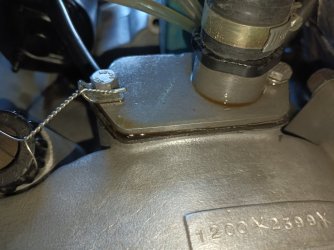

I've had a minor weep around the circular part of the crankcase breather ( getting worse) or I should say I think its coming from there .
I've found another, albeit a bit ugly looking atm. This one has strengthening ribs which would suggest Laverda had instances of this item cracking prior to the upgrade.
Am I thinking along the right lines?
Rob

Someone once said a good test for that rubber breather ball's ability to seal was to try and bounce it; a hard ball was a bad ball. It would take some insane crankcase overpressure to crack that breather container.
I wondered where you were going with that Vince.
However, if it is cracked, its unlikely pressure that causes it but vibration, harmonics etc.
Rob
Rob
Yep.
I'll check my stash, might have a nicer one for you. I'll bring it to the 'ring. ;)
