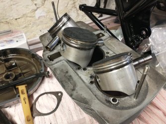

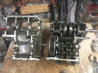

With 35k miles on the clocks everything checking out as low wear good condition, just a 3mm thick black sludge in the bottom crankcase no metal shavings or hard bits.....do you guys think it's worth it having the crank split to clean the slingers?

why did you dissasemble?
It's been unused for twenty years all the other parts of the bike are being restored so while the engine was out, it was no big deal to dismantle it to make sure an engine problem wasn't why it was left. I didn't want a catastrophic engine failure to happen, parts are expensive and scarce
Front plastic cam chain guide looks well heat effected, good move to replace it. Like your logic, our safety is number one, and other road users.

Hmm...it's not cheap, so depends on your intentions for the bike, but I had my crank done by Keith, slingers were close to full! Also had rods replaced..turns out they were bent...Keith has had Arrow rods made for these bikes. And ask Keith to show you head gasket failures...he has a bespoke solution, newly designed, does away with O rings, correct flame ring etc. you are lucky to be close..it's a schlepp from Kent up on the train, bike transported, ridden back over 2 days. Mind you, I discovered the beauty of the Borders!

Personally Hubert, I think you are wasting your money but I am a cheapskate. I did a 1200TS engine in a far worse state than yours. spent very little on it and had Maurice Turner torture the bike on the way to Breganze in blistering heat. Yours will never get the beating that motor had and it ran like a train. Keith will always find something wrong because he's a perfectionist.

I know what you're saying but time for biking is running by and I want to ride it for a good long while. The crank turned out good, he's going to get it up to his standards for being true, the heads getting new oversized stem valves and smaller exhaust valves with UL seats. Cam towers mating surface on the head machined and new billet cam towers, cracks welded and machined. Original bores and pistons ok for wear but ring grooves worn so will be machined oversized to take thicker rings. Vapour blast and rebuild..
I'd intended to build up the engine myself but he said he could put it together for me and use his know how in doing it...the gear clusters are good, bearings etc. And he'd build up the clutch which I understand can be problematic to the uninitiated with the plate springs. He's also going to slot the cam sprockets and dial in the cams.
