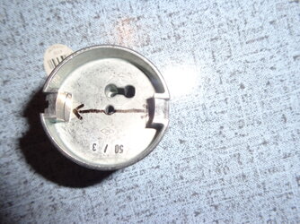

... I would need three 60/2 slides. Any idea who has them in stock? Or anyone has three unused slides lying around?

The gap indicated by the darts has to be at least 28,5mmcurrent slides part number 11570 will have to be modified to fit the early carburettors.
You don't need the tick over screw ramps on a triple anyway, surely?The gap indicated by the darts has to be at least 28,5mm
