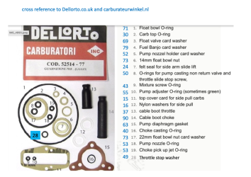

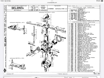

I added cross reference (in blue) to Dellorto.co.uk and carburateurwinkel.nl. There was one item missing in the list, now numbered '28' instead of '8' in the picture. That is the throttle stop washer #49 of the Dellorto diagram.
