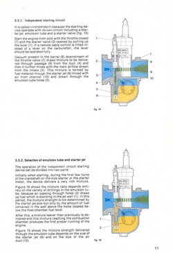

Inside the fuel bowl, in one corner a brass tube proceeds from the carb body down into a small round recess. What is its function?
The tube has an O ring at its low end which seals the recess around it. If that tube is a fuel pick up, how does the O ring assist? Wouldn't it cut off fuel reaching the tube?
Thanks
