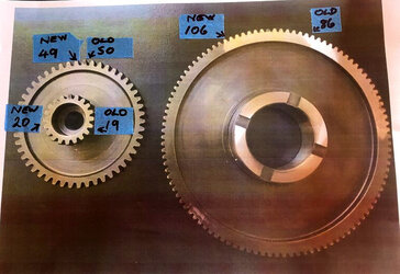

All Denso did was to change the brush plate (rotate them by 90°, is it? You'll know better than me ...). Denso part numbers: 128000-6050 for the Ducrappis, 228000-6520 for the Zanès.
I've done the 4-brush conversion, btw (750 Formula). Didn't make a lot of difference in my experience. It seems the only real solution (once you've fitted the biggest battery you can and upgraded the cables) is to change the gearing. 3C Moto used to have the kits for this, but I understand they've now sold out.

Chaz,
See my reply above to John :-). This question has been MUCH MUCH discussed over the years, so I'll be brief:
1. Fit the biggest - that means with the most CCAs - battery you can. I use a Westco.
2. Fit the biggest cables you can.
3. Change the solenoid. The Hitachi unit can struggle.
4. Check the brushes are in good nick. They seem to be exceptionally soft and leave filth and residue all over the commutator.
5. Try a 4-brush conversion. I did, but didn't notice much difference.
6. Change the gears (see above).
And: jab the starter button, don't hold it on.
