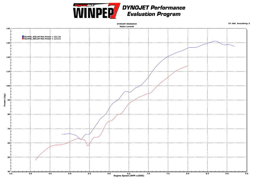

Dyno run, 7C Cams, 1160cc, Dual valve springs, 42mm Inlet valves, 33mm Exhaust valves, Gas ported Ross pistons, 38mm Mikuni carbs, 13.4 CR, ported Inlets, welded up Exhaust ports, race fuel 103 octane, 3.8% oxygenated
This was Dyno run 29 out of 55, we did make slightly more power by the time we were above 50 runs but not much, 134.6 hp was our best
Run 29 was after we modified the 3-1 again but we also increased the length of the angled Inlet manifolds by 20mm which gave us a 13hp gain through the mid-range and removed the flat spot we had there
Inlet manifolds are tapered 36mm at the head to 38mm at the carbs
Held power curve through to 8,700 rpm, set our 1st shift light to come on at 9,000 rpm, 2nd shift light at 9,250 rpm, rev limiter set at 9,500 rpm
This was October 2018, since then all I have done to my race engines is to keep modifying them to get them to be reliable
Been a big learning curve

Extremely impressive results, thanks for sharing both the dyno charts.
Interesting , all if it.... the gain from extending the inlet manifolds.

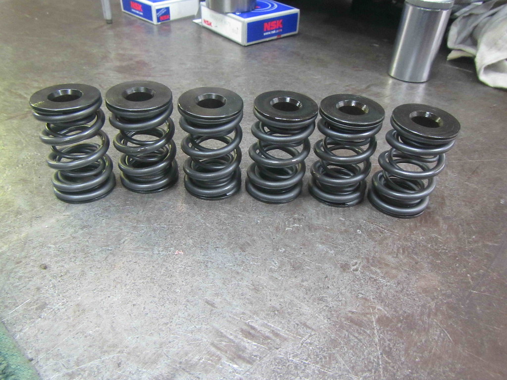

Do double springs require different retainers/bases ?
Yes, inner springs need to be supported and need the correct load on them
I used PAC-Alloy dual valve springs made for some Honda car engine and then we machined our own spring seats and top retainers
Uses the standard Laverda collets
Will only work with the later 81 model and later RGS/RGA/SFC Cam buckets which have a larger ID and shorter length and thus are lighter which is a bonus
We have them anti-friction coated hence the finish, believe I have a set in stock in my race engine spares but can source more and easy to machine the seats and top plate as we have them CNC programmed
dual springs
