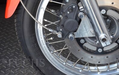

Image on loan from Wolfgang Fuchs, danke Wolfgang! ;)
Thanks for your feedback so far. I like Dell'Ortoman's idea that both are sloppy used abbreviations which stand for one and the same caliper P2F08. A further distinction is made after the back slash (e.g. shaved/narrow).
