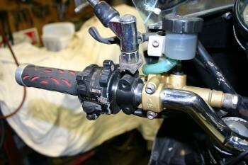

you just need to fit one of these and the clutch is as light as a helium filled balloon. All other things need to be good of course, the ball in the slave cylinder (round and free) the ball between the two pushrods (round and free) the thrust bar at the back of the cluctch drum, (straight, not bent no serious indentation), I also find that my Ducati master cylinder lever needs to be removed and the pivot greased occassionally, it still carries the same load even though you dont "feel" it.

Gees Thank you Guys for all the suggestions. Very helpful. Clem when you say "fit one of these" is that the Ducati Monster clutch master cylinder that most refer to. And the other point is I better dismantle the clutch assembly to makes sure all is ok.
not sure of model designation, (Paddy will know) it was an auto jumble find for peanuts and worth the "fit and see" installation method but a great result, as anyone who has tried it will tell you, they think I have only three clutch springs installed.
