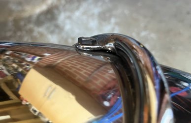

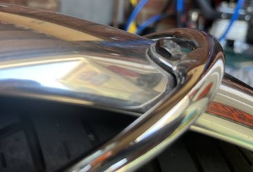

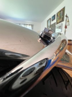

Do Laverda fenders always fit this crappy?
CDHE
Full member
Boulder, Co
Was thinking I will need to fashion some wedge shaped nylon washers because the fender will distort if I tighten any more.
These bikes did suffer from quality control. I'm sure you did but make sure the fender is not flopped. The brace could've bent from the fork mounts that should be rubber mounted, so maybe loosen them to align the fender mount better.
Mine don't sit flush, but nowhere near that bad.
Do things improve if you swap front to rear around?
Loosen it all up and wiggle it around.
If that doesn't suffice, bend that tab with a pair of pliers and be done.
Quality control?
They aren't all rubber mounted Ted, only the later ones.
