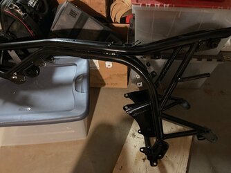

The serial number (1688) is stamped horizontally. Paul, can you see what you are looking for in the attached photo of the frame? I will go take a better one if not. These were quick and dirty, with poor light.
Eric
That would be a first time wide frame then Eric. It would have specific side panels as well to go with the curve of the rear rail.

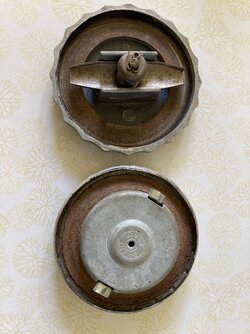

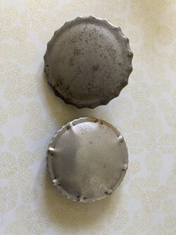

Marnix, I can't tell if you're pulling my leg or not, but your comment caused me to compare the cap that came on the original Super Sport coffin tank of my AE and the cap from Larry's early GT. They are different (see photos), but they are interchangeable. In the photos the top one is from the fiberglass tank. Is the one from Larry's tank not "original"? Or did they use more than one type of cap on the early bikes?
There was only one type of cap Eric, the top one. You'll notice that there's no venting hole in the cap, hence my reference to the venting/overflow tube.

For which I am grateful, Marnix. I get enough of a mental workout decoding some of Paul's comments. Anyway, the correct cap does have a small hole drilled near the edge on top. You can see it at about 9 o'clock in the first photo (you might need to zoom in). I have not confirmed if it goes into the inner area where it would function for venting. But I'll have a closer look today. It makes sense that the alloy one is the correct one. The other one is very much more cheaply made, not Laverda's style at all. But I think it would be functional.
