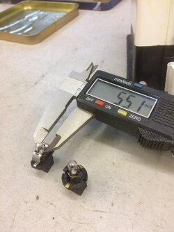

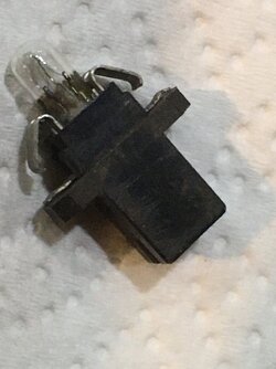

Does anyone know the correct name, or a source of the kind of bulbholder shown in the attached ( I hope ) photos. it's from the top of the RGS instrument binnacle. There should be two I guess as there's two sockets/apertures mine only has one. Despite visiting every auto electrical supplier I can find on the www though I can't locate one. Everyone does the push and turn type needed for the actual warning lights but can't find any of these anywhere. Not th end of the world, butas I've got it out to check out the state of the tacho, I thought it wuld be good to put one in before it all goes back together but no luck so far.IMG_5936.JPGIMG_5937.JPG

It’s a “Wedge”, T5 I think (I can check tomorrow) and it pushes into the plastic holder. Commonly available but don’t throw away the holder… 👍

I have a bulb, it's just the holder I needed and thanks to Charley I have just managed to get one from The Motor Works , though I had to pretend to own a 1984 BMW R80 RT in order to order online! £5.20 + p&p. They did have used for £2.50 but "hang the expense!" nothing but the best for the old girl
For interest 🤓 I have two panels that had two different bulb holders 🤪. The I measured doesn’t fit both.
The holder is a reasonably standard fitment, B8.5D, which takes the same wedge lamp, so there are a few manufacturers.
