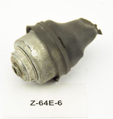

Not sure what you mean by "Bosch drop keys need replacing", please clarify if you think it's something you need help with.

Bosch "drop key" as I call it is code # 76110987 75 on page 93 of Laverda 750 Operation and Maintenance Spare Parts List. Never had a problem w/ it. Don't know why Grn Bk says replace it, I believe I have an electrical issue on it cutting out while riding. I bought 15538 back in 1984 as a parts bike for Sf8787 which I rode until 1987. Sf 8787 I originally got in 1981 traded a Yamaha 350 Rd. Rode it for 8 yrs. In the process of redoing it. Then I bought Sf2 17580 in 1987 which I rode until 1995. Sf2 did cut out when riding. Never could figure it out. Didn't cut out all the time. but it had the connector box under the seat. Just rebuilt 17580 w/ Ross pistons & lesser head. Sold a lot of parts in the 90s off it. Sold sf2 frame w/ title 2011. Still have odds & ends from Sf2 but I always liked the original racer...so much for history.

A classic for your symptom is the ignition switch, either the contacts inside or the soldered wires on the back of it. Many of us have fitted a mini relay so that the switch doesn't have all the bikes power going through it.
OK, I did wonder if that might be what you were referring to but could not see it on 17580 which would have the later, very reliable key switch.
It's not the push in key itself but the contacts on the switch mechanism inside the headlamp shell that will need care - likely they're corroded or may even have bits broken off. If cleaning up all the contacts doesn't resolve the cutting out issue then replacement of the whole switch mechanism with a modern key switch mounted wherever is convenient is probably your best option.
The Bosch switch as on the earlier twins was also used on BMWs like R75/5 of the era and you could try to replace with same if you want it to be as original as possible.
