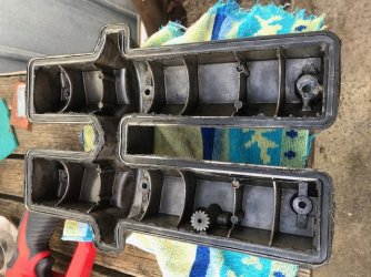

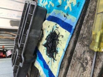

They had used blue silicone for the crankcase halves, red for the head and grey for the primary cover.
Aye, took a bit of effort to remove it.
Found this lot just on the cam cover.....  :o
