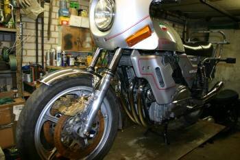

sorry Marnix but Lothar is humering you, I have never known you to be wrong, not ever but this time you are, stainless front guards on Marzochi 1200's are solid mounted, they are tin things, long, and the mount flexes, it should be loose when sttling the forks, but that is extreme and unnecessary , it does zero in terms of maintaining the distance between the legs which is correct, you dont want them solid here, just extra firm, if they need to move, then let them move. heres a picture.
I hope we are still friends Marnix

My SF1 with 35mm Ceris and the drum brake had a solid mounted front guard - the rubber inserts arrived with the SF2/38mm Ceris. So a Drummer would have had a solid mount guard as well.
The early triples with the 38mm Cerianis also had solid mounted mudguard brackets. If they were distorted in any way, it was quite impossible to attain acceptable fork action. Those brackets are damn solid! The rubber mounts arrived somewhere around '75-'76.
The later brackets on theMarzocchi forks are quite flimsy in comparison.
