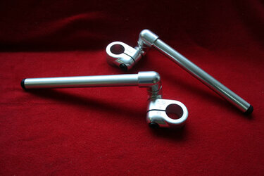

I know RGS Executive handlebars are unavailable, but Tommaselli makes a high rise clip-on that might be a good substitute. From what I can suss out they're 75mm tall. I was hoping someone with an Executive might measure the rise/height on their bars and report back. Thanks in advance!

Round a bout 60mm.
Thanks hooksey. I remember somewhere coming across a reference of approximately 2.5 inches, which is 63.5mm. The Tommaselli's might be too tall, but might adjust enought to fit with the Executive dash pad.

Oh be careful with those Tommaselli ones those suckers can come loose if you not careful.

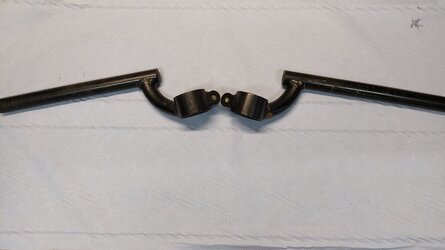

I have a pair of original Executive bars. (I might fit them on my RGS, when I get old😉) Please se attached photo regarding the high of the bars.

That's a big help, thanks Preben. If you decide to part with them, let me know. The trick, I think, in fitting anything else is trying to match not only the rise, but the angle of the rise and of the angle of the bars from the rise. It looks like Tommasellis and possibly a few others will work, but I wonder if the clutch and brake masters can be positioned to properly fit the dash pad. Regrettably, I have no welding skills or I'd try and mock up a set.
