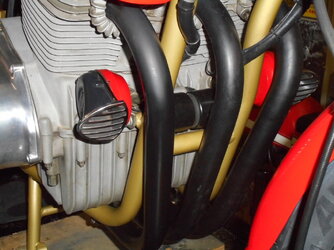

I recently removed the factory three into one exhaust system on my new (to me) SFC. The bike was supplied
with factory three into two system. From part numbers on websites it appears fitting from the left hand when
seated the pipe # LAV-63101059 is then followed by # 60 then the outer R.H. pipe being # 61. The other two
exhaust pipes supplied are #'s 57 and 58. Is the sequential numbering correct in the parts book ? Should the
lowest number be fitted on that L.H. # 1 cylinder ? Thanks for helping out on this fitting issue.
I have fitted the pipes according to forum advice. Attached are two photos which I hope
someone can look at (Even though in two dimensions) and comment on whether the sequence
of fitting appears correct. Everything seems to fit properly. Thanks.

If you managed to fit the pipes and silencers without straining them then you have them in the right order. Impossible to say with certainty from your photos.. collector position under the crankcase should be central between frame rails and silencer inlets equally spaced on each side of the frame
mostly people dont bother or make "seat of the pants/guesswork" changes
