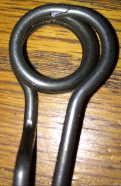

Firstly, check that the gear lever snaps back to its original position when pushed down with your finger, as you flick your finger off the lever.
The hairpin spring, when tired, causes poor selection problems, prior to fracturing.
Always worth carrying a spare.

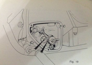

Although this is from the Triple Handbook, it's the same procedure for the SF750. Check this first.
Then this, best done with fourth gear already selected.

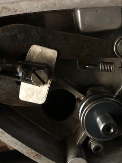

I had a similar symptom where I could upshift consistently but downshifts were a problem when the return spring end was getting trapped between the moving frame and the eccentric post of the internal mechanism so that it would not permit full downwards movement of the lever.
If that's happening, then replacement of the spring ensuring it's not flipped back to front and perhaps some thin shim washers to prevent it getting misaligned and catching in the jaw should fix it.

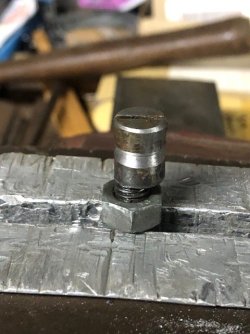

I seem to recall there was discussion here (perhaps piranha-bro2?) of making a groove in the eccentric post to keep the spring aligned to avoid this entrapment?
I find that a slower and deliberate movement of the lever is more effective than a sharp jab, fewer missed shifts.
Correct, Arancia. i had already made a rectangular 'shim' to stop the spring fouling the moving bracket but added the groove later - it's a better shape for the job than a simple round one. I could effectively remove the shim as the groove works a treat. It also eliminates the small amount of slop that some setups exhibit. I'v e seen several selector issues that were simply the spring fouling the moving bracket - definitely a design flaw.

I'll post pics again, including my idea for a tool to record how far you are adjusting and in which direction. The angle alu is used in place of a screwdriver and you can mark the gasket surface of the selctor case before making an adjustment.
Selector spring retainer.jpgSelector eccentric customise.jpgSelector adjustiong tools.jpg

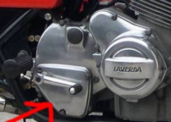

You need to drain the oil or lean the bike to access the selector mechanism.

I put a 20mm rimber packer under the right side leg of the centrestand, with a safety rope tied off on something solid in case you bump the bike. You might lose 100ml of oil, so try to catch it. That also gets the rear wheel off the ground so you can spin it when checking for gears. Watch where all the washers on the shafts are. And read Mr Socks' manual thread, there is a notch on a shaft that must be horizontal when the bike is in neutral, so the gearing is timed correctly. Expect to do this more than once. It can be tricky.
