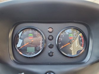

Some of you have seen this on FB, but I know some dislike the Vaguelia dash as much as me, so here goes. Since every other system on my RGS is either new or maximized, I decided I couldn't live with the ever-hopeless tach, wavering as it did all over the place. We replaced the input chip without improvement; I bought a frequency generator and tried to calibrate it, which it would do at the calibration RPM but not elsewhere. Pffft. Be gone, Veglia!
Utah's Speedhut to the rescue, with their fully customizable gauges. Stepper motor tacho and GPS speedo with Novitatech idiot lights. Works very well; GPS speedo does drop signal in tunnels and briefly a few other places around town, but is otherwise rock-steady. And dead-accurate. I'm chuffed.

Kristian, that looks very nice and well made! is that rubber between the inner fairing and the instrument plate the same as for the headlight? looks a bit alike...
ksoholm said:
Hahaha, 3D printed. Made entirely by hand with 3/8" ABS.
Oh come on,  get with the times! Being kind of broke right now I was thinking of going for one of these or similar. There's quite a few different formats. https://www.ebay.com.au/itm/402305792318
Thanks, similar, it is high quality general edge trim from an auto parts store, has adhesive inside so it stays put.

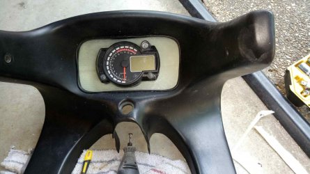

Getting the cutout right was PAINFULLY TEDIOUS. Now to paint the panel. Couldn't find black abs so made the panel out of fibreglass and epoxy. Hope the stupid thing works! At least now I can rev it right up to 15k!
Hey Drikko, instead of painting it why not laminate it with a nice piece of walnut burl? Very classy 8)
